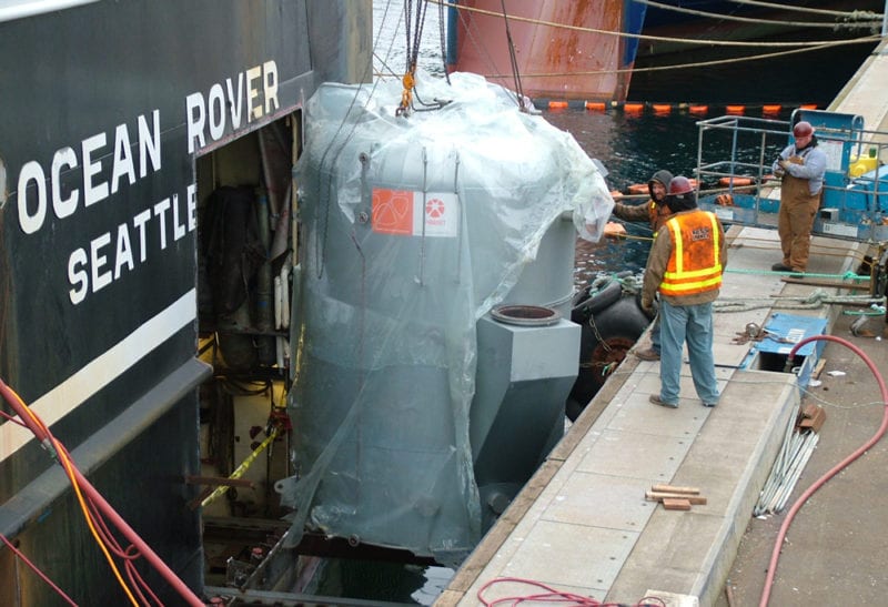

Operators of existing vessels with combined PARAT boiler installations as well as boiler systems from other manufacturers can upgrade steam production arrangements with the PARAT ECS Electrical Circulation Steam boiler, optimised for steam boiler retrofits. This allows users of existing steam boilers to add electrical system benefits, both via Shore Power-based steam production and back-up during transit. The compact solution enhances flexibility and reduces through-life maintenance costs in the process.
The boiler, which can be set to automatic mode for unmanned engine room operation, can be used as a source of extra power during routine voyages and as a means of reducing fuel consumption. Similarly, its electrical connection can be delivered at 400V, 440V or 690V. The unit’s programmable logic controller (PLC) can be connected to a vessel’s main control system by standard ethernet / profibus / modbus links.
PARAT’s Svindland commented: “The ECS boiler can be added to any existing marine or offshore boiler to provide an electrical connection as a back-up, enabling generator loads to be optimised and for shore power to be used when available. Installations, which can be vertical or horizontal depending on layout and space constraints, can be undertaken on existing vessels in port or at sea, with the retrofit upgrade and boiler optimisation managed by PARAT as a turnkey project.”
The ECS boiler is available as a standard modular unit in capacities up to 500kW, equivalent to 750kg steam per hour. More powerful units are also available on request.
