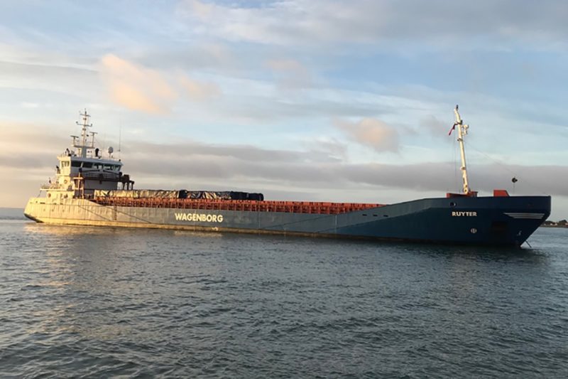

The M/V Ruyter. Photo courtesy MAIB

The general cargo vessel M/V Ruyter ran aground on the north shore of Rathlin Island just after 11 p.m on 10 October 2017 when the master, who was the sole watchkeeper at the time, left the bridge unattended.
