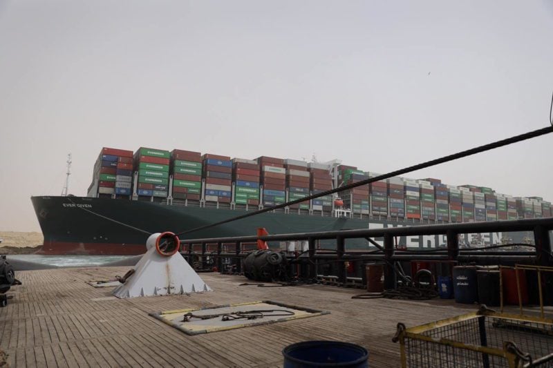

Pictures now seen across the globe of the vessel spread fully across the canal, point to the first major hurdle. It ran aground both at the front and at the back, almost perpendicular to the canal walls. That’s leaving very little room to simply tow it away from either end, SMIT says.
For now, the focus is on dredging around the vessel. The canal authority has dispatched two of its dredgers, the Mashor and the 10th of Ramadan, to remove sand from underwater before rescuers attempt to pull it. From the shore, excavators are also working around the vessel. Western shipping experts who analysed photos of the Ever Given calculated that her protruding bulb was as much as 5 meters buried into the canal wall.
