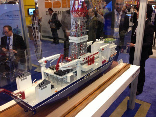

A model of the OVERDRILL design on display at OTC in Houston. Photo: gCaptain

The new design, called the “OVERDRILL”, was developed by Fincantieri in cooperation with Aker Solutions and will be able drill to an overall max depth of 50,000ft.
Fincantieri says that compared to other drillships of this category, the OVERDRILL design will feature an increased variable deck load capacity, reduced overall dimensions, and increased efficiency.
