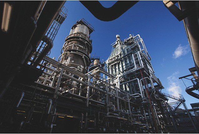

ExxonMobil’s refinery in Antwerp, image: ExxonMobil
