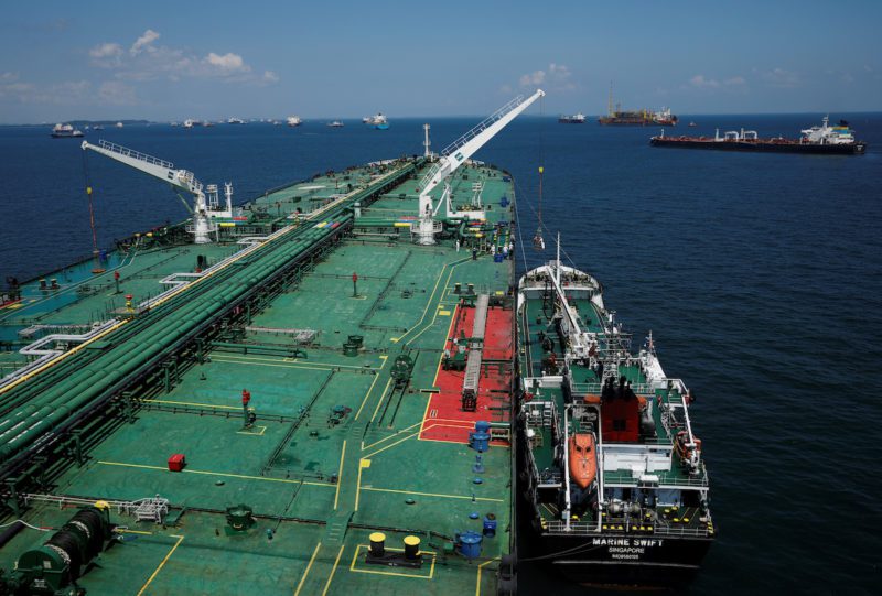

A bunker vessel prepares to supply fuel to Hin Leong’s Pu Tuo San VLCC supertanker in the waters off Jurong Island in Singapore July 11, 2019. Picture taken July 11, 2019. REUTERS/Edgar Su
reuters logo By Roslan Khasawneh and Chen Aizhu ONBOARD THE PU TUO SAN, July 25 (Reuters) – Off the coast of Singapore, the world’s largest ship refuelling centre, a bunker barge sidled next to the supertanker Pu Tuo San to fill the giant vessel with a new type of fuel that will meet global standards that start up in January.
With a little over five months left until stricter marine fuel rules come into effect, shippers such as Singapore’s Ocean Tankers that own the very large crude carrier (VLCC) Pu Tuo San have started testing out lower sulphur fuel to prepare their fleet for the transition.

The Reuters energy team boarded the Pu Tuo San on July 18, which loaded about 1,000 tonnes of VLSFO for the first time. The ship also loaded 2,000 tonnes of high-sulphur fuel oil. A laden VLCC will typically burn about 55 tonnes of fuel oil per day at a normal cruising speed.
