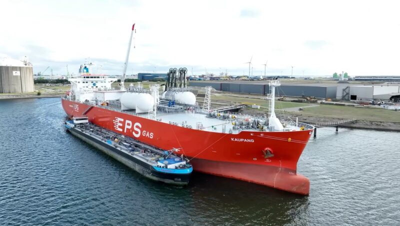

Gas carrier Kuapang taking on biofuel bunkers in the Port of Vlissingen

The Global Centre for Maritime Decarbonisation (GCMD) has announced its latest successful biofuel supply chain trial, part of a pilot to develop a quality, quantity and greenhouse gas abatement assurance framework for drop-in green fuels.
This latest trial involved a biofuel blend of hydrotreated vegetable oil (HVO) and marine gas oil (MGO) as pilot fuel for LPG propulsion in a mid-sized gas carrier equipped with an LPG dual-fuel engine, which can reduce emissions compared to conventional fuel oil. The gas carrier, named Kaupang, was provided by Eastern Pacific Shipping (EPS).
Approximately 200 MT of the B30 biofuel blend was provided by GoodFuels and bunkered in the Port of Vlissingen (Flushing), Netherlands.
The trial involved a tracer in HVO to assure its origination and quantity in the biofuel blend. Veritas Petroleum Services (VPS) conducted extensive laboratory tests on aliquots of the biofuel and biofuel blend collected at numerous pre-determined points along the supply chain to assess quality.
GCMD said the HVO used in this trial has a well-to-wake emissions of 16 gCO2e/MJ, translating to an 83% reduction in emissions compared to using fossil MGO, and the trial demonstrated a 20% net reduction in emissions compared to the Kaupang sailing on VLSFO.
