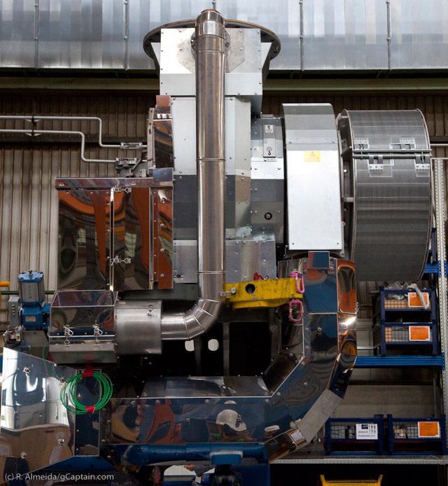

ABB turbocharger
ABB turbocharger outfitted on a Wärtsilä medium speed diesel
