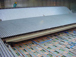

Loading Bananas. Photo By Tom Guldner
This is done today on container ships and break-bulk carriers that carry produce. The usual manner the oxygen is removed from the cargo hold is by the introduction of nitrogen or other inerting gas. An inerting gas simply pushes the oxygen out of an area and then takes its place. Actually the inerting gasses are usually non-toxic in themselves however, the lack of oxygen will kill anyone who enters the area without an SCBA.

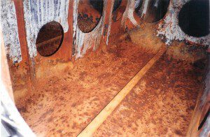

rusty ship ballast tank
Rust in ballast tank. Photo By Tom Guldner
Other areas aboard ship which may contain dangerous levels of gasses or reduced oxygen are the ballast tanks (photo left) and other areas within the hull. These areas are generally sealed and not normally occupied. Accumulations of water, sewerage, and cargo leakage may cause a hazardous atmosphere of either toxic gasses or a lack of oxygen.
Normal air contains twenty one percent (21%) oxygen. As this level is decreased, the danger to anyone entering that space increases. It becomes a hazard when the level drops below 19.5%. The progression is as follows:
