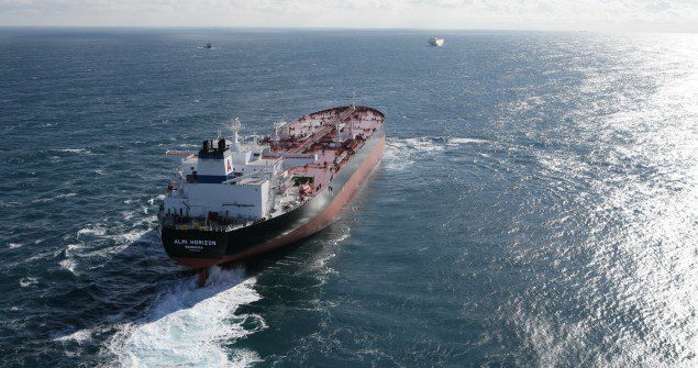

almi horizon lloyd's register
Almi Horizon, Image: Lloyd’s Register
