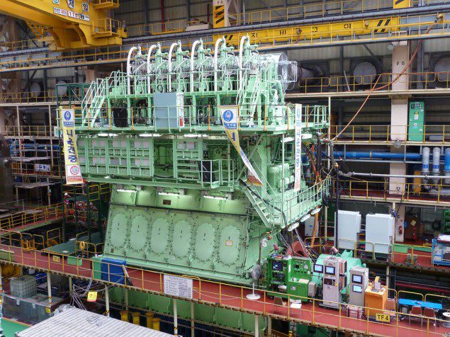

The MAN B&W 6S80ME-C9 engine with integrated EGR pictured at Hyundai. Image: MAN B&W
