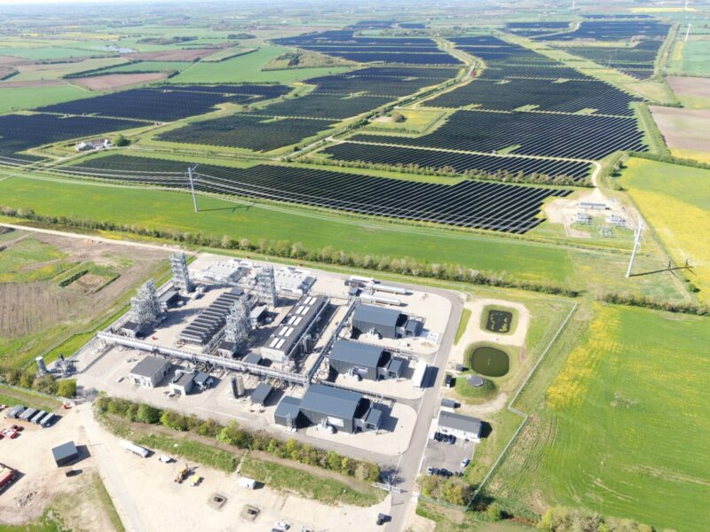

COPENHAGEN, May 13 (Reuters) – The world’s first commercial-scale e-methanol plant began operations in Denmark on Tuesday, with shipping giant Maersk set to buy part of the production as a low-emission fuel for its fleet of container ships.

Located in Kasso in southern Denmark, the new plant, which has cost an estimated 150 million euros ($167 million), will produce 42,000 metric tons, or 53 million litres, of e-methanol per year, its joint owners Denmark’s European Energy and Japan’s Mitsui said.

The Kasso plant will make e-methanol using renewable energy and CO2 captured from biogas plants and waste incineration.

Excess heat generated from the e-methanol production will be used to heat 3,300 households in the local area.
