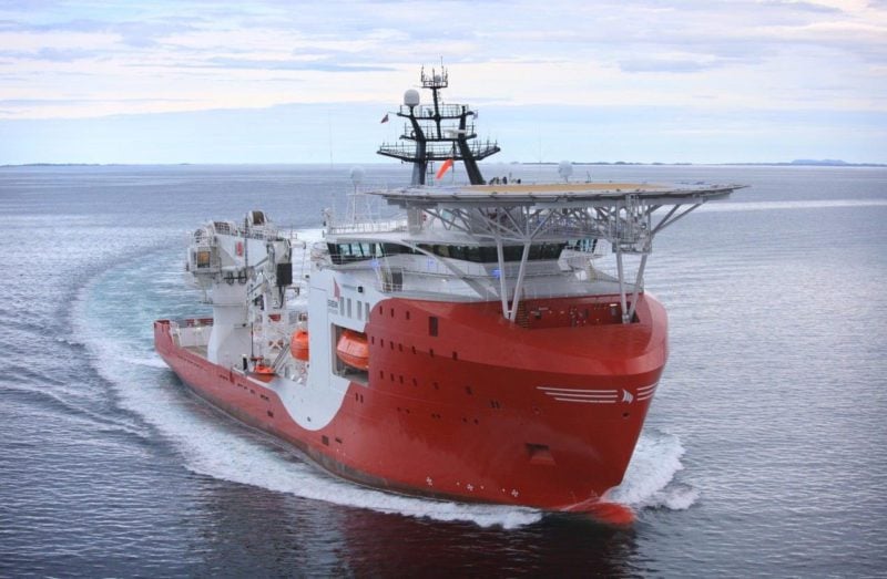

Press Release – Vard Electro has secured an order with Siem Offshore to deliver its largest battery package to date for a vessel retrofit as the Norwegian shipowner proactively upgrades its fleet with hybrid power in pursuit of greener and safer operations with lower fuel costs.
The newly signed contract covers Vard Electro’s SeaQ Energy Storage System (ESS) with two battery packs and a DC link, which will be installed in the first quarter of 2022 on one of Siem Offshore’s subsea construction vessels lined up for work in the wind sector.
The system will enable the vessel to operate in fully electric mode with zero emissions while manoeuvring in harbour or other restricted areas and will deliver estimated fuel savings of up to 20%, according to Vard Electro Head of Commercial Sales, Gisle Anderssen.
