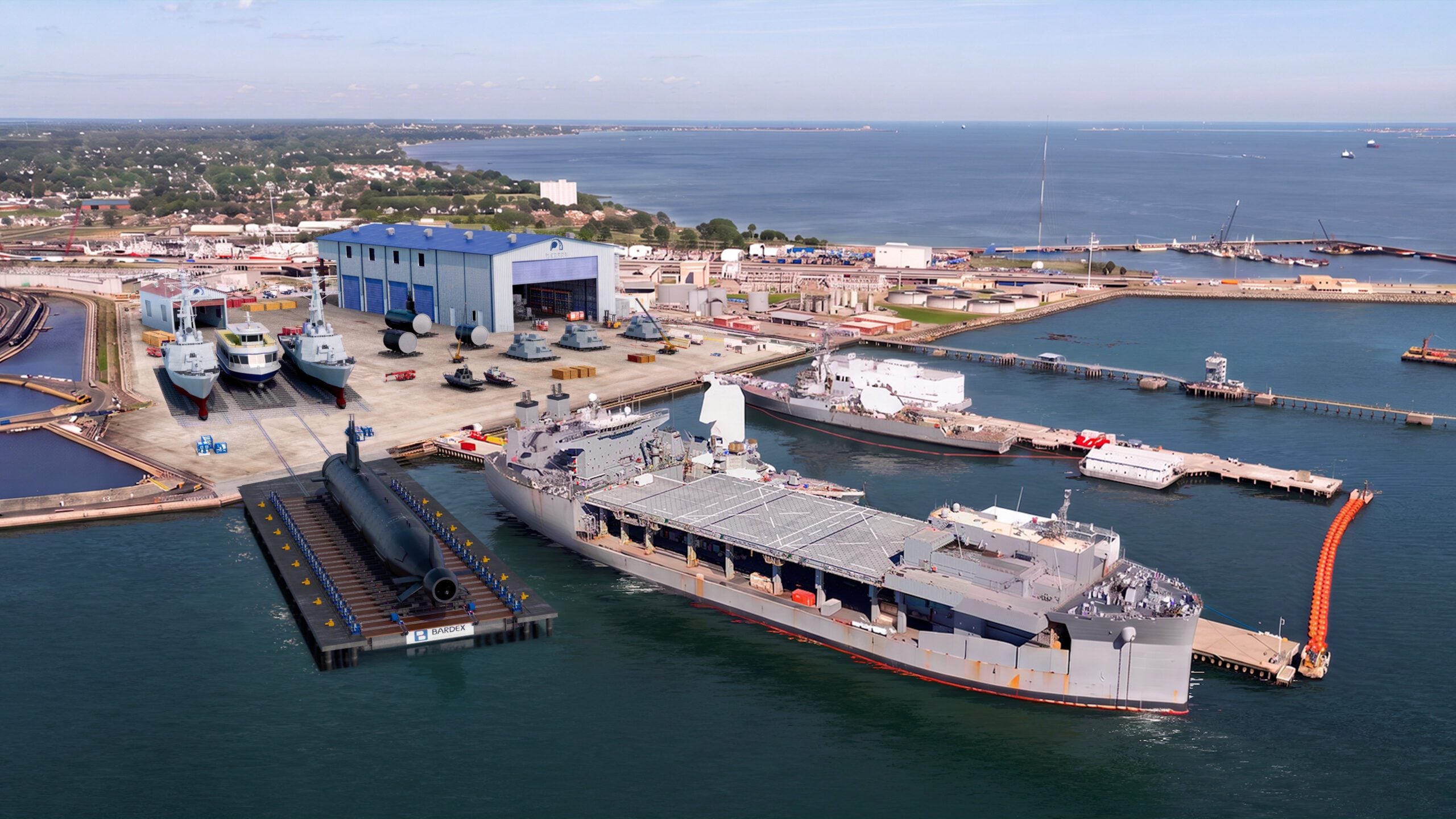

The Bardex OmniLift® shiplift will be engineered for the specific requirements of the Newport News facility, including forty-eight 640Te lift stations and a platform measuring approximately 450ft x 110ft (137m x 33.5m).
The system will be designed to deliver precise load control, reliability, maintainability, operational flexibility, and life cycle value.
Unlike wire rope-based shiplifts, the Bardex OmniLift system uses linear chain jack technology to provide synchronized, controlled lifting without relying on wire ropes as the primary lifting medium. In addition, the system will use motion control technology instead of synchronous motors or variable frequency drives to keep the lift safe, level, and reliable under real-world conditions. In contrast with wire rope shiplifts, the Bardex OmniLift has a perfect safety record: Since the company first installed its linear chain jack system, in 1967, there have been zero catastrophic failures, dropped vessels, or reportable safety incidents.
