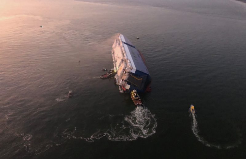

Two years after MV Golden Ray capsized while departing the port of Brunswick, Georgia early in the hours of September 8, 2019, the National Transportation Safety Board released their final report on the incident. The accident occurred as the ship, under the supervision of an embarked pilot, executed a 68-degree turn heading out to sea.
With the vessel increasing speed, and 20 degrees of rudder ordered, Golden Ray heeled past 8 degrees and never recovered. The ship maneuvered out of the main shipping channel, but with a list of 60 degrees to port, and an open hatch for the pilot, the vessel flooded and sank to the bottom of St. Simon’s Sound. The Coast Guard and tugs responded and quickly removed the pilot and nineteen members of the crew. Rescue efforts cut out the remaining four crew trapped on board.
