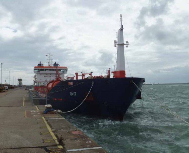

Photo courtesy MAIB
The UK Marine Accident Investigation Branch has released its report from an investigation into the September 2013 grounding of the chemical tanker Ovit in the Dover Strait.
Early on September 18, 2013, the Malta registered tanker Ovit ran aground on the Varne Bank in the Dover Strait while carrying a cargo of vegetable oil. The vessel remained aground for just under 3 hours, there was no injuries or pollution, and damage to the vessel was considered superficial.
Through their investigation, MAIB found that poor use of the electronic chart display and information system (ECDIS) was the primary factor in the incident. The investigation showed that Ovit’s primary means of navigation was the ECDIS display, which the officer of the watch followed even though the route shown passed directly over the Varne Bank, and MAIB said the analysis of this system, its installation, training and operation formed the backbone of their report.
