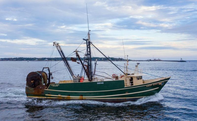

The NTSB said Tuesday the fishing vessel Emmy Rose likely capsized in 2020 after seawater collected on the aft deck and flooded into the vessel through deck hatches that were not watertight. NTSB investigators also found that two freeing ports, designed to drain water, were closed. That caused the vessel to list starboard, further reducing the Emmy Rose’s already compromised stability.

Although investigators could not definitively determine the source of initial flooding, it most likely began through the lazarette hatch’s cover, which did not have securing mechanisms and therefore could not be made watertight. That allowed following seas—seawater that flows in the same direction as the vessel—and accumulating water on deck to flood down into the lazarette, a compartment below the deck in the aft end of a vessel.
