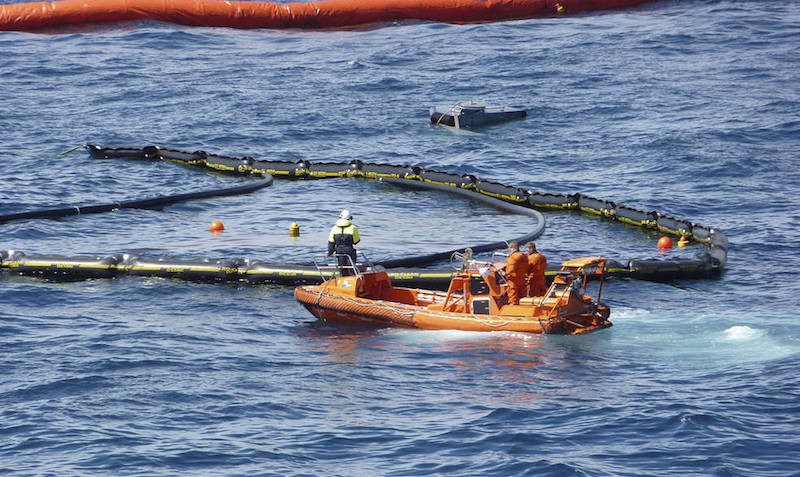

File photo shows Norway’s Oil on Water exercise from 2010. Photo: NOFO
