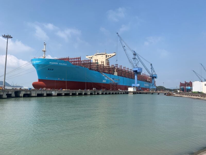

MAN Energy Solutions has completed the world’s first retrofit of a Very Large Container Vessel (VLCV) to enable green methanol operation.
The Maersk Halifax, a 15,000 TEU containership, underwent an extensive 88-day transformation at China’s Zhoushan Xinya Shipyard, marking a significant milestone in shipping’s decarbonization journey.
The ambitious project involved converting the vessel’s original MAN B&W 8G95ME-C9.5 engine to an 8G95ME-LGIM Mk10.5 unit, capable of reducing CO2 emissions by 90%. The retrofit included comprehensive modifications such as new fuel tanks, a fuel preparation room, and a fuel supply system. Additionally, the ship’s hull was extended by 15 meters, increasing its capacity to 15,690 TEU.
