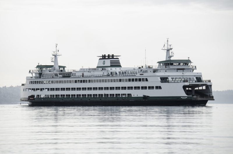

An improperly tightened fastener led to a diesel engine failure on a Washington State Ferries passenger and car ferry near Bainbridge Island, Washington, the National Transportation Safety Board (NTSB) said Tuesday.
Marine Investigation Report 22/06 details the NTSB’s investigation into the April 22, 2021, catastrophic failure of the no. 3 main engine aboard the Wenatchee during a sea trial in Puget Sound. The failure led to the ejection of components from the engine and resulted in a fire in the no. 2 engine room.
No injuries or pollution were reported, while damages were estimated at nearly $3.8 million.
