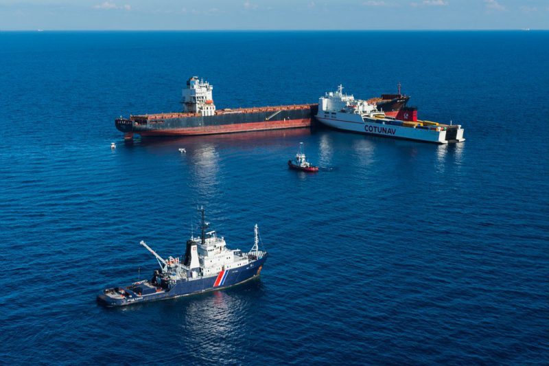

The Tunisian ro-ro Ulysse pinned to the hull of the CSL Virginia in the Mediterranean Sea off Corsica. Photo: Prémar Méditerranée

The Ulysse was underway from Genoa, Italy to Tunisia when it collided with the CSL Virginia, which was at anchor approximately 17 miles of the island of Corsica early in the morning on 7 October 2018. The collision resulted in the bow of the Ulysse penetrating deep into the hull of the containership, resulting in the release of some 500 cubic meter of heavy fuel oil.
The two ships remained connected for days before they were eventually seperated.
