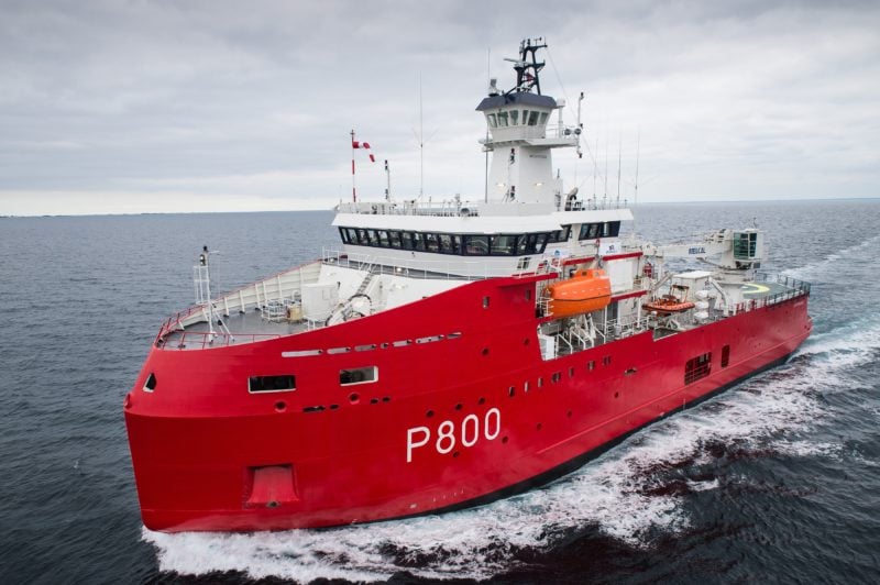

The French Navy’s patrol and polar logistic ice-breaker, L’Astrolabe. Photo: courtesy of PIRIOU.
The launch of the L’Astrolabe, a 72 metre polar logistics vessel fitted with a complete Wärtsilä propulsion machinery package and Wärtsilä NOR (NOx Reducer) SCR (Selective Catalytic Reduction) exhaust gas cleaning systems for all the main engines, took place on July 12. This is the first vessel operating with the International Maritime Organisation’s IMO Tier III EIAPP (Engine International Air Pollution Prevention) certified Wärtsilä diesel engines.
The ship was built by PIRIOU (France) for the French Southern and Antarctic Lands Administration. It will be used to transport personnel and supplies to the Dumont d’Urville research station in Antarctica.
The four IMO Tier III certified 8-cylinder Wärtsilä 20 diesel engines are combined with Wärtsilä NOR systems to be fully compliant with the IMO Tier III exhaust emission regulations set out in Annex VI of the MARPOL 73/78 convention. The IMO Tier III EIAPP certification was carried out according to Scheme B based on the requirements of IMO Resolution MEPC.198(62). The Tier III EIAPP certificates were issued by Bureau Veritas.
The full Wärtsilä scope of supply for this vessel comprises four Wärtsilä 20 main engines, two Wärtsilä controllable pitch propellers and shaft lines including Wärtsilä reduction gears, Wärtsilä NOR systems, and a Wärtsilä tunnel thruster.
