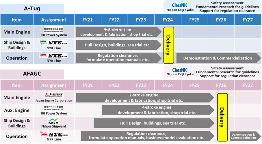

(1) Development and operation of an ammonia-fueled tugboat (A-Tug)
The ammonia fuel will have a flame retardant bottleneck, which is difficult to ignite, so this project assumes that a small amount of fuel oil will be used as pilot fuel. Targeting the delivery of A-Tug in FY2024, the companies aim to reduce GHG emissions by achieving an ammonia fuel mixed combustion rate of 80% or higher.
The companies will confirm safe operation in demonstrations aimed to improve the mixed combustion rate with a view to achieving zero GHG emissions by using biofuel as a pilot fuel in the future.
NYK LineProject management, ship design and legal compliance
IHI Power Systems Co., Ltd.Research and design of four-stroke engine***
Nippon Kaiji Kyokai (ClassNK)Safety assessment of A-Tug
Image of A-Tug
(2) Development and operation of an ammonia-fueled ammonia gas carrier  (AFAGC)
Targeting the ship’s delivery in FY2026, the Companies will develop and operate an ammonia-fueled ammonia gas carrier (AFAGC) with the concept of transporting ammonia as cargo and using the cargo and ammonia gas vaporized from the cargo as fuel during the voyage.
The Companies aim to reduce GHG emissions by achieving a maximum ammonia fuel mixed combustion rate of 95% for the main engine that moves the ship, and an ammonia fuel mixed combustion rate of 80% or more for the auxiliary engine that runs the generator.
Japan Engine Corporation
Research and design of two-stroke engine (main engine)****
IHI Power Systems Co., Ltd.Research and design of four-stroke engine (auxiliary engine)
Nihon Shipyard Co., Ltd.
Development of hull, examination of ship construction method
Nippon Kaiji Kyokai (ClassNK)Safety assessment of AFAGC
Image of AFAGC
Schedule
Period: December 2021 to the end of March 2028
Demonstration project schedule

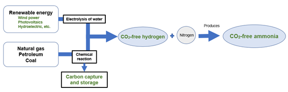

** CO2-free hydrogen
One way of producing hydrogen without generating CO2 is through the use of renewable energy. A second way is by using natural gas or coal together with carbon capture and storage. CO2-free ammonia synthesis is technology for synthesizing ammonia using such CO2-free hydrogen.
