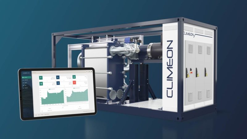

Climeon AB is launching its new waste heat recovery technology, HeatPower 300 Marine, on the maritime market at SMM, 6-9 September 2022. Developed for the maritime industry, HeatPower 300 Marine generates clean electricity from low-temp waste heat produced by a ship’s engines.
Enhanced Energy Output
Capable of producing up to 355kW of carbon-free electricity from a single unit, HeatPower 300 Marine delivers enhanced performance and optimal energy output. Created for larger vessels with an engine size from 15MW and up, Climeon’s latest HeatPower product delivers superior economic and environmental benefits, alongside reduced payback times and streamlined installation.
Its modular, scalable and SOLAS-compliant design ensures maximum onboard waste heat can be repurposed into clean electricity. Up to three HeatPower 300 Marine units can be installed on a single vessel, depending on the available thermal energy, delivering up to 1MW of renewable power.

Low-Temp Waste Heat Recovery
While most waste heat recovery products rely on high-temp heat inputs, Climeon’s patented HeatPower technology uses low-temperature waste heat to generate renewable, carbon-free energy. As most of the heat produced on board ships is low temperature, this increases the availability of thermal energy and maximizes clean energy outputs.
HeatPower 300 Marine can generate clean electricity from waste heat at temperatures as low as 80 degrees Celsius. Climeon’s low minimum temperature requirement means that HeatPower systems can rely solely on jacket cooling water or HT cooling water to produce carbon-free power, thus simplifying the installation process and increasing the applicability of waste heat recovery throughout the maritime industry.
Automated Monitoring and Management
The Climeon HeatPower Control system monitors and manages onboard electricity production for optimal performance and can easily be integrated into a ship’s existing management system, meaning minimal on-site supervision is required. Its autonomous operation ensures that maximum thermal energy is utilized, with the system going into standby mode if no waste heat is available.
Additionally, the optional cloud-based Climeon Live system provides ship-to-shore data collection, real-time analysis, performance monitoring, fault diagnostics, rapid alerts for pre-emptive maintenance and finetunes running parameters for optimal energy production.
