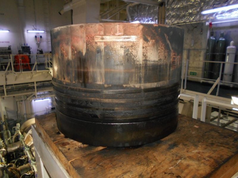

Some ship owners using very low-sulphur fuel oil (VLSFO) have reported build-up of red deposits on piston crowns and top edges, sometimes combined with red iron burrs in scavenge ports. The deposits are associated with abnormal liner wear (or scuffing) since the fuel switch, particularly on older two-stroke marine engines.

Chevron used a four-step laboratory analysis to narrow down likely causes. The deposits were found to include a compound of materials including harmless detergent additive residue and iron oxide. The detergent residue was determined not to be a source of wear as the deposits were only found in single cylinders rather than across the engine.
