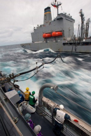

Like commercial ship operators, the U.S. Navy faces astronomical costs and logistical challenges when it comes to keeping their vessels fueled and ready for when duty calls.
In 2011 alone, the U.S. Navy Military Sealift Command, the primary supplier of fuel and oil to the U.S. Navy fleet, delivered nearly 600 million gallons of fuel to Navy vessels underway through a fleet of 15 replenishment oilers strategically place around the globe.
With these challenges in mind, scientists at the U.S. Naval Research Laboratory say they may have found a way to turn seawater into jet fuel for a renewable and cost effective source of energy to power the Navy’s fleet.
Refueling Navy vessels at sea can prove in many ways to be a costly endeavor. The U.S. Naval Research Laboratory (NRL) is developing the chemistry for producing jet fuel from renewable resources in theater. The process envisioned would catalytically convert CO2 and H2 directly to liquid hydrocarbon fuel used as JP-5. (U.S. Navy Military Sea Lift Command)
