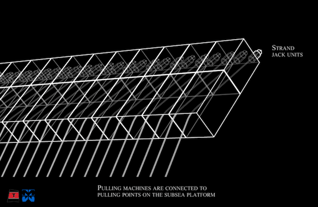

Install the flotation tanks on the port side by welding to framework which was previously attacked to the hullPulling machines are connected to pulling points on the subsea platformWith flotation tanks and pullers in place, we can begin to roll the ship upright
