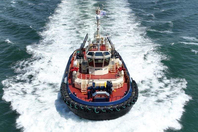

Robert Allan Ltd. is pleased to announce that the Svitzer Elizabeth was successfully delivered to Svitzer at Uzmar’s shipyard in Turkey. The newly completed RAstar 3200-W was designed by Robert Allan Ltd. and will be the first Uzmar tug to be part of Svitzer’s European fleet, operating in the Port of Liverpool, England.
The combination of 80+ tonnes bollard pull, escort, Fi-Fi 1, exceptional seakeeping and < 500 GT of this design has proven successful for Uzmar and Robert Allan Ltd. This will be the twelfth hull to this design to be delivered, with more on the order books.
