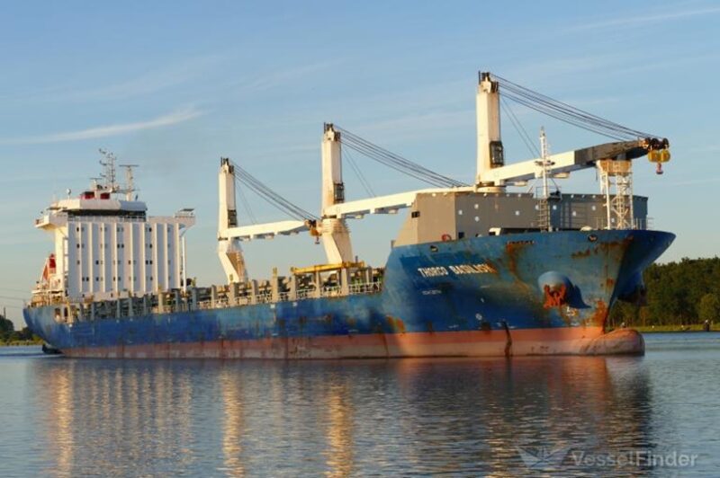

M/V Thorco Basilisk pictured underway before the equipment failure. (Source: VesselFinder via NTSB)

A recent incident involving a cargo ship in Houston has brought attention to the importance of regular maintenance and inspection of equipment. According to the National Transportation Safety Board (NTSB), undetected corrosion and wear led to an equipment failure on the cargo ship Thorco Basilisk while offloading cargo at the Greensport Terminal on the Houston Ship Channel.
On July 23, 2022, the ship was offloading a wind turbine component when the hoisting wire rope on one of the cargo cranes failed, causing the component to drop onto the vessel’s cargo hold tween deck. Fortunately, no injuries were reported, but damages to the ship and cargo were estimated to be between $3-5 million.
An examination of the hoisting wire rope revealed significant external corrosion and wear that had gone unnoticed. The grease on the rope had concealed the visible signs of corrosion. While annual visual inspections were conducted on the wire ropes, they did not detect the underlying corrosion below the grease.
The wire rope, which had been in use for 9 years, was still within the standard 10-year period of use. However, a post-casualty examination determined that the wire rope was near the end of its service life and should have been discarded. The operating company has since updated their maintenance system to require crane wire rope replacement every 5 years.
