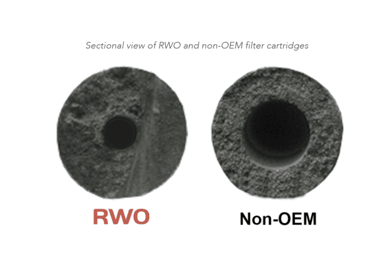

Beyond superficial similarities such as shape and colour, a close physical comparison of OEM and non-
OEM filter cartridges can reveal key differences between the two. For example, OEM cartridges are
heavier and more robust, with their smaller pores creating a smoother surface structure which offers
superior oil capture.
Beyond the visual clues, tests show that OEM filters contain more active carbon, which ensures better
performance and durability.
