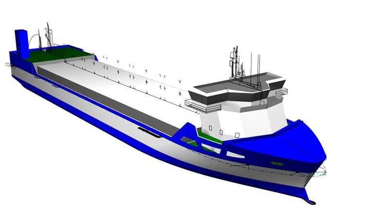

Three LNG fuelled short-sea vessels for Bore Ltd will be equipped with optimized Wärtsilä integrated LNG systems. Copyright: Conoship/Bore
Wärtsilä will supply all the main equipment for the first LNG fuelled short-sea Ro-Lo (roll-on, lift-off) vessels to be operated by Finland based Bore for the transportation of  paper products in Europe
Wärtsilä has worked with both the owner and naval architects to develop a vessel optimised integrated LNG system. As a result, it has been possible to locate a 250 cbm Wärtsilä LNGPac storage and supply system below deck without compromising the cargo capacity. The ships have been ordered and are being built at the WuHu Shipyard in China.
The ships will each be equipped with Wärtsilä ProTouch controls and Eco Control to enable accurately synchronised engine speed and propeller pitch. These integrated technologies will be supported via Wärtsilä’s Data Collection Unit (WDCU) with cloud-based services and remote monitoring to optimize operability, fuel economy, and periodic maintenance.
The 120 metre long, Ice Class 1A classified, ships will be chartered to Finnish forestry company UPM, and will operate in the Baltic and North Seas. The first vessel is scheduled for delivery Mid 2021.
