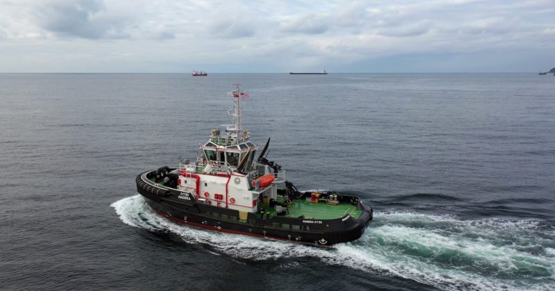

Press Release – Robert Allan Ltd. is pleased to announce that Hadera, a RAmparts 3200-SD ASD tug was successfully delivered to The National Coal Supply Corporation of Israel. The newly developed 32 metre ASD tug with escort notation was constructed at Med Marine’s Eregli shipyard and is the third Robert Allan Ltd. designed tug to operate in this Middle Eastern country.
Hadera has a large deadweight capacity, a shallow full load navigational draft of 4.81 metres, and high standard noise control. She is a very quiet boat, especially in the wheelhouse and crew cabins located in the deckhouse and on the lower accommodation deck. The name Hadera is also the name of the port where the vessel will operate.

Records taken during sea trial show none of the crew cabins have noise level higher than 54 dB(A). This means the extremely quiet boat will provide comfortable working and living environment for its crew.
Trial results were as follows:
  • Bollard pull, ahead: 77.5 t
  • Free running speed, ahead: 14 knots
