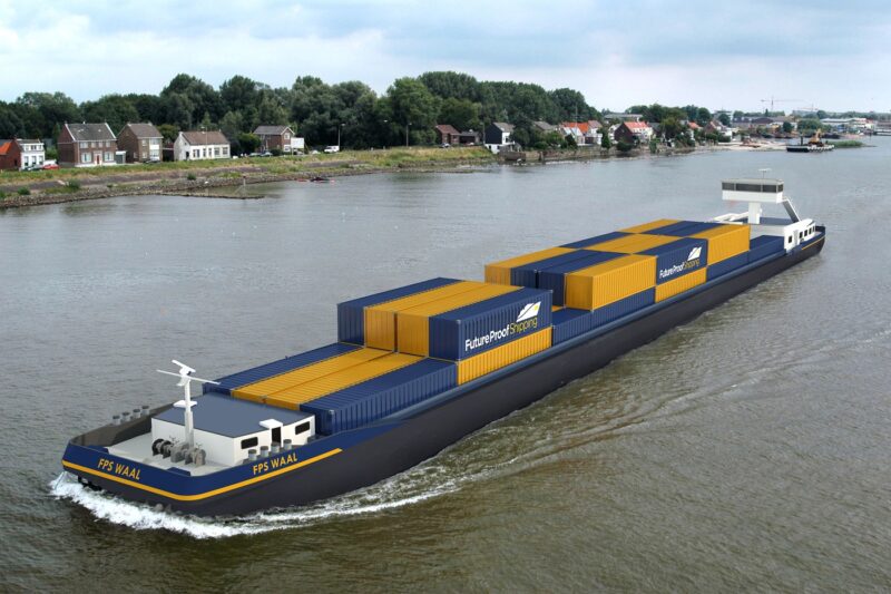

Marine battery manufacturer AYK Energy is reinforcing its position as one of the sector’s prime innovators after signing a new deal with Holland Shipyards Group (HSG) to supply the zero-emission container vessel the FPS Waal.
AYK Energy founder Chris Kruger said the Andorra based company is increasing production at its factory in Zhuhai, China to supply the retrofit project at HSG’s shipyard in Werkendam. He said the contract will see AYK supply two high density DNV approved Aries 88 lithium batteries to the vessel. He confirmed the 125 watt hour/kilogram (Wh/kg) batteries will be installed on Future Proof Shipping’s FPS Waal, which is the second inland container vessel in its fleet to be retrofitted, following the FPS Maas.  The FPS Waal’s retrofit involves its diesel engine being replaced with a propulsion system consisting of PEM fuel cells, hydrogen storage, AYK’s battery packs and an electric drive train. Once complete the FPS Waal will be powered by green hydrogen with around 1,200kW of installed power and a cargo capacity of 200 TEU.
