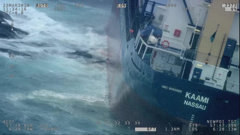

The UK Marine Accident Investigation Branch has issued its report into last year’s grounding of the general cargo vessel Kaami on the west coast of Scotland, revealing holes in the vessel’s voyage planning process prior to the grounding.
The MV Kaami ran aground on Sgeir Graidach shoal in the Little Minch, on the west coast of Scotland, early in the morning on March 21, 2020. The crew was safely evacuated by a Coastguard helicopter with no injuries, but the ship stayed aground for over a month before it was eventually refloated by salvors on May 4. No pollution was reported, however the vessel itself was declared a constructive total loss and was later scrapped.
