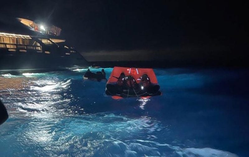

The MY Utopia IV and oil products tank vessel Tropic Breeze were transiting the Northeast Providence Channel on December 23, 2021, when the two vessels collided. The Tropic Breeze’s engine room flooded, and the vessel eventually sank. The vessel’s seven crewmembers abandoned ship and were rescued by a Good Samaritan vessel. Three of the 12 crewmembers on the Utopia IV were injured.
