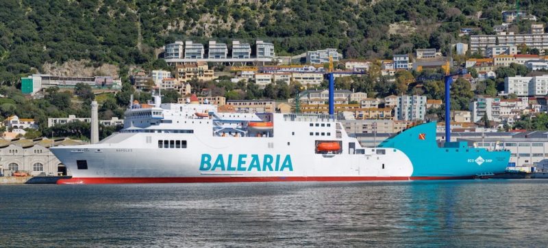

The converted Nápoles alongside at Gibdock before reentering service with Baleària

Napoles arrived at Gibdock in November. By that time, the yard already having pre-fabricated two LNG bunker fuel reception stations for later installation. The majority of the remaning work took place alongside the yard’s main repair wharf. Some elements of the conversion also took place in Gibdock’s Panamax size Dock No.1.
Gibdock says the project required extensive modifications to the ferry’s Deck 1 to accommodate the 200 tonne, 27m x 6m diameter LNG fuel tank from Wärtsilä. Gibdock also cropped Decks 5 through to 2 to create a route through which to lower the 400m3 capacity tank.
Another key part of the project was the modification of the MAN 9L 48/60-A main engines, which was undertaken by engineers from MAN Primeserv. Now designated 9L 51/60DFF, Gibdock assisted modifications made by the manufacturer with auxiliary pipework and steel structures in connection with reassembly, also fitting specialised valves, a compressor and generator unit.  Extensive automation system and cabling work was also carried out by Gibdock technicians.
