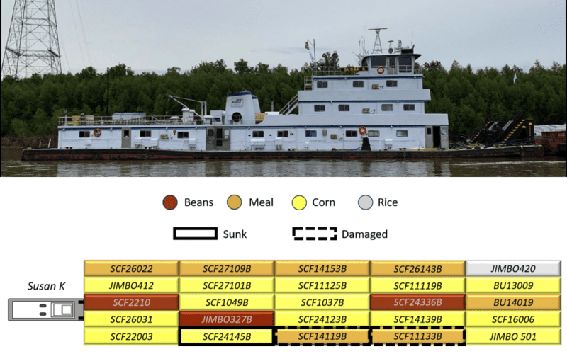

The incident occurred on April 23, 2023, when the Susan K, accompanied by 25 barges, was navigating downstream.

The Susan K’s tow struck the bridge at approximately 22:42 local time. The incident resulted in one barge sinking and damage to two others, with an estimated cost of $2 million. Fortunately, there were no reports of pollution or injuries.
