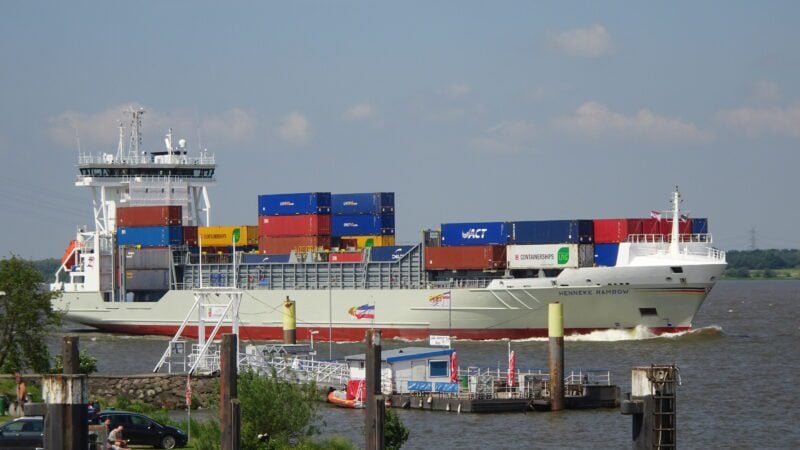

Latest BERG Propulsion project to upgrade the fuel economy and emissions performance of a German-flagged shortsea container ship on charter to CMA CGM exceeds expectations when it comes to the efficiency of older ships.
A 2007-built containership has been redelivered as one of the most efficient vessels of its type, according to its owner, following a DNV-approved retrofit and upgrade project requested by charterer CMA CGM.
The leading shipping and logistics group asked German owner Reederei Rambow to undertake a comprehensive package of efficiency optimization measures onboard the 868TEU capacity Henneke Rambow to match current and anticipated fuel efficiency and emissions performance requirements.
The joint project saw CMA CGM and Reederei Rambow work with BERG Propulsion to realise a series of efficiency gains, after BERG undertook a holistic review and data-based analysis of the ship’s propulsion system, including its existing propeller. The assignment is the latest in a series of BERG retrofit projects which help older ships enhance their efficiency and respond to expectations on carbon intensity.

With Henneke Rambow consistently operating below the service speed envisaged at the time of its delivery, BERG’s systematic review focused on optimizing the propulsion solution for fuel economy.
The project saw new BERG propeller blades installed that are hydrodynamically optimized for its full operational profile. The owner’s retrofit project also included optimization of the ship’s bulbous bow for a revised operational matrix.
