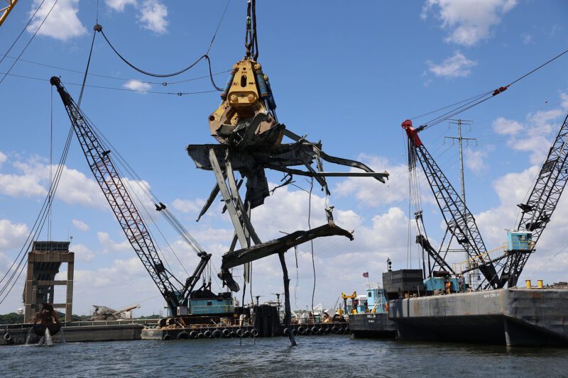

The Chesapeake 1000, aka “Chessy" floating crane equipped with “Gus” the hydraulic grabber, wrestle a 90-ton piece of residual wreckage Friday morning, June 7, 2024, from the Fort McHenry Federal Channel. Taking roughly 45 minutes to unfold, Chessy and Gus slowly lift the mangled steel high above the Patapsco River, so a waiting barge can move underneath, allowing the wreckage to be safely lowered onto the barge for immediate processing by waiting hydraulic sheers. U.S. Army Photo

Salvage crews in Baltimore have successfully removed the final large steel truss segment of the collapsed Francis Scott Key Bridge. The segment had been blocking the 700-foot-wide Fort McHenry Federal Channel since the bridge’s collapse ten weeks ago.
The operation, carried out between June 3-4, involved the use of concrete breakers, underwater surveys, and oxyacetylene torches. Crews worked meticulously to separate tons of concrete roadway, cable, and steel rebar from “Section 4C”. The debris was then removed using clamshell dredges.

The task involves delicately handling roadbed material, crushed containers, and remains of the bridge on the ship’s bow. The removal is in preparation for the refloating of the Dali. USACE has estimated there is 3,000 to 4,000-tons of bridge wreckage on the Dali, which is essentially pinning it to bottom/piling.
“The complexities of this next phase of operations require thorough preparation, strategic planning, and specialized expertise,” said Capt. David O’Connell, Federal On-Scene Coordinator, Key Bridge Unified Command. “We have the right team making this work happen in the safest and most efficient way possible.”
Officials aim to remove the Dali by May 10, after which a 45-foot-deep section of the main shipping channel is expected to reopen.
Specialized equipment is being used to precisely monitor the positioning and movement of the ship and the bridge wreckage in contact with it. To facilitate the removal of the steel structure, referred to as “section four,” 182 containers have been removed from the ship.
Key Bridge Response salvors use a diamond wire cold-cutting tool to sever steel bridge wreckage lying on the M/V Dali on April 26, 2024.
Key Bridge Response salvors use a diamond wire cold-cutting tool to sever steel bridge wreckage lying on the M/V Dali on April 26, 2024. Key Bridge Response photo
