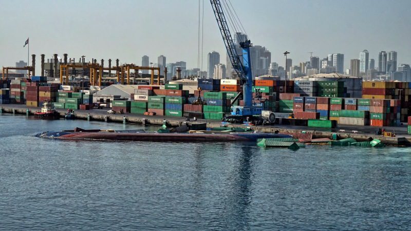

Photo via Shipspotting.com
You might be tempted to assume that the above photo (courtesy of ShipSpotting.com and Vitaliy Kharchenko) is of the Comoros-flagged SL Star. That feeder container vessel capsized in Bandar Abbas, Iran on March 19th during cargo operations with up to three casualties reported. Strangely, though, the photo is of the Comoros-flagged Mona, another feeder container vessel, after capsizing in the UAE port of Sharjah in August 2017.
There are remarkable similarities between the two incidents. According to IMO GISIS Marine Casualties and Incidents,Mona capsized,”…due to wrong unloading the containers in conjunction with wrong calculations of loading fresh water and discharging ballast water…”AfterSL Star capsized, it was reported that, “…discrepancies between dockers and crew led to stability loss, either cargo shifted or was wrongly loaded…”
