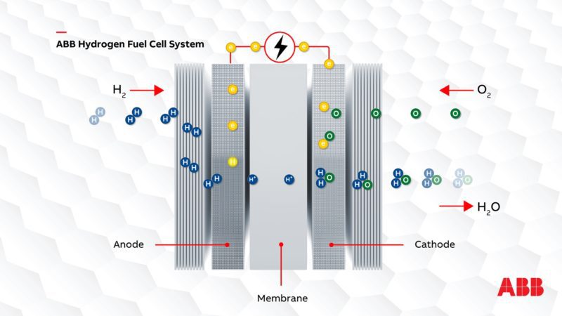

Fuel cells generate energy by exploiting an electrochemical reaction at the interface between the anode or cathode and the electrolyte membrane. They involve no combustion, converting fuel directly to electricity and heat.
“At ABB, we believe that the next generations of vessels will be electric, digital and connected. Fuel cell technology matches exactly that. Fuel cells have significantly higher efficiency than combustion engines and allow energy to be concentrated more densely than in petroleum fuels. If you use renewables to produce the hydrogen the entire energy chain is clean and truly emission free,” Koskela continues.
The pilot installation, including control, converter and transformer technology from ABB, will generate 100 kW of energy, and has been fully developed, marinized, assembled and tested by ABB Marine & Ports. ABB selected an FCvelocity® proton exchange membrane (PEM) pure hydrogen fuel cell engine from Ballard Power Systems for its pilot system.
