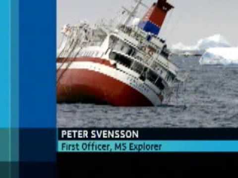

YouTube Preview Image
The news reports at the time gave the impression that the ship was in mostly open water and just happen to hit some ice but as you can see from the photos in the report, the vessel was in ice.
