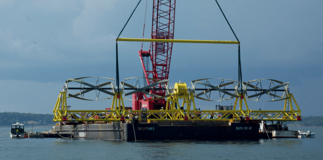

ORPC’s TidGen™ turbine generator unit being readied for installation at Cobscook Bay Tidal Energy Project site. Image (c) ORPC

The device, called a TidGen, is designed to operate in shallow tidal or deep river sites at depths of 50 to 100 feet , and has a peak output of 180 kilowatts. That amount is enough electricity to power 25 to 30 homes annually.
In April, the Maine Public Utilities Commission approved a 20-year power purchase agreement for ORPC’s Maine Tidal Energy Project (which includes the Cobscook Bay Project) with three utilities: Central Maine Power, Bangor Hydro Electric, and Maine Public Service. Two additional TidGen devices will be installed at ORPC’s Cobscook Bay Project site in the fall of 2013, and together, the three-device power system will generate enough energy to power 75 to 100 homes.  The devices connect directly to an onshore substation through a single underwater transmission line.
