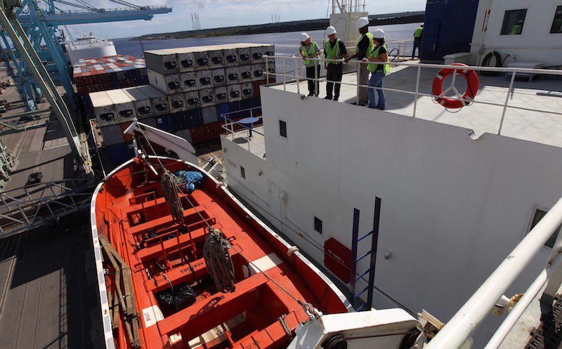

NTSB investigators inspect an open-top lifeboat onboard El Faro's sister ship, El
NTSB investigators inspect an open-top lifeboat onboard El Faro’s sister ship, El Yunque, while docked at Jacksonville. Photo: NTSB
