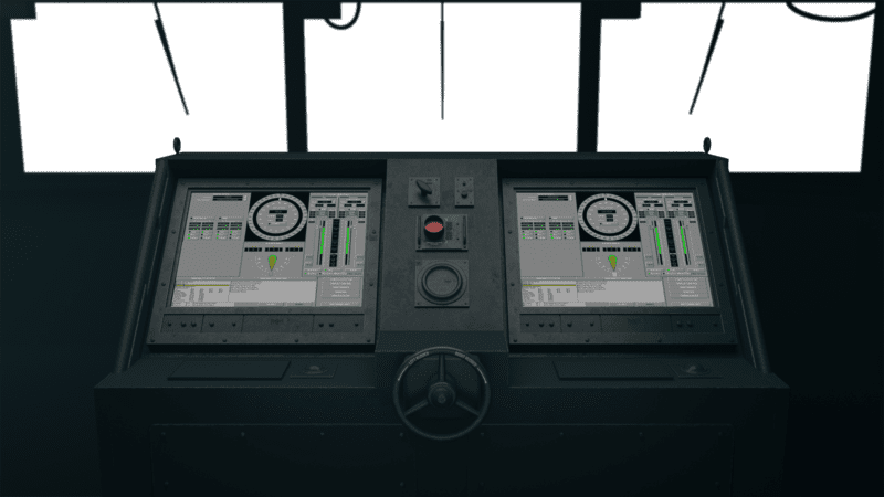

To guide the McCain, Bordeaux relied upon a navigation system the Navy considered a triumph of technology and thrift. It featured slick black touch screens to operate the ship’s wheel and propellers. It knit together information from radars and digital maps. It would save money by requiring fewer sailors to safely steer the ship.
Bordeaux felt confident using the system to control the speed and heading of the ship. But there were many things he did not understand about the array of dials, arrows and data that filled the touch screen.
“There was actually a lot of functions on there that I had no clue what on earth they did,” Bordeaux said of the system.

Its very design, investigators determined, left sailors dangerously vulnerable to making the kinds of operational mistakes that doomed the McCain. The Integrated Bridge and Navigation System, or IBNS, as it was known, was no technical marvel. It was a welter of buttons, gauges and software that, poorly understood and not surprisingly misused, helped guide 10 sailors to their deaths.
Despite its issues, the IBNS operated for years without major incident. Navy sailors did what they have always done: They found ways to make do with an imperfect technology.
The NTSB put it plainly: “The design of the John S McCain’s touch-screen steering and thrust control system,” the board found, “increased the likelihood of the operator errors that led to the collision.”
The Navy investigators, for their part, determined that the system’s “known vulnerabilities” and risks had not been “clearly communicated to the operators on ships with these systems.”

The IBNS, however, indisputably played a role in the confusion that unfolded from the initial mistake.
In its normal, computer-assisted mode, the navigation system requires that both sailors press buttons to acknowledge a switch in steering before it happens.
But in the backup mode preferred by Sanchez, no such protection existed. Instead, the IBNS software makes “automatic offers” to other steering stations on the ship allowing them to take unilateral control.
The reason? In cases of emergency, such as if the bridge is destroyed during an attack, sailors from other parts of the ship need to be able to take control without waiting for additional approval.
Whatever the exact cause, neither Bordeaux nor Mitchell realized during the emergency that Mitchell had control of steering. Each man had an indicator on screen displaying the name of the station with control. But it wasn’t prominent — just a small box with green text a little larger than the 12-point font typically used in word processor programs.
When Bordeaux tried to turn the ship, he thought the McCain’s steering had malfunctioned. As trained, he called out loss of steering.

THE MCCAIN can be controlled from the IBNS stations on the bridge and from a backup station in the rear of the ship.
The helm and aft stations featured a fail-safe device known as the big red button. Once pressed, the big red button overrides all other stations and returns control to its own location.
But numerous sailors on the McCain believed that the function of the big red button was to send steering control to the rear of the ship. It is unclear how this misunderstanding developed, or why it was so widespread among the crew. Mitchell told investigators that the instruction booklet on the bridge had not been updated to match the most current version of the IBNS.
The confusion over the big red button was the center of the fourth, and final, mistake of the night.
With the steering seeming to malfunction, a ship’s officer ordered the sailors in the aft station to take control.
At 5:23:01 a.m., a sailor pressed the big red button at the aft steering station. For the first time in more than two minutes, someone had control of the McCain’s steering.
It did not last long.
Up on the bridge, another sailor responded to the officer’s order by hitting the big red button there in the mistaken belief that it sent control to the aft station. Just seconds after sailors in the rear of the ship seized control, it returned to Bordeaux’s station on the bridge.
After a few seconds of hurried conversation, the aft station finally regained control of the ship at 5:23:27 a.m.
All told, steering of the McCain changed hands three times in 16 seconds. During one of the transfers, the ship’s rudders mysteriously turned the McCain briefly and sharply left, hastening the turn toward the shipping lanes.

The review found that the “designed responses of the IBNS” featured “known vulnerabilities” in shifting steering and thrust.
The Navy’s training schools do “not address the depth of knowledge and skills needed to properly maintain complex electronic navigation systems on ships, specifically the Integrated Bridge Navigation System.”
The review offered a critique of the Navy’s drive to save money by installing new technology rather than investing in training for its sailors.
“There is a tendency of designers to add automation based on economic benefits (e.g., reducing manning, consolidating discrete controls, using networked systems to manage obsolescence),” the report said, “without considering the effect to operators who are trained and proficient in operating legacy equipment.”
Adm. Phil Davidson, then the head of training and manpower for the Navy, led the review. The Navy fired or forced out five senior commanding officers above Sanchez, the McCain’s captain, including four admirals. Davidson was promoted to his current position, the head of Indo-Pacific Command, one of the most powerful posts in the military.
Later that fall, the Navy appointed four-star Adm. Frank Caldwell, who reported directly to the chief of the Navy, Adm. John Richardson, to investigate whether the McCain sailors deserved additional punishment.
As Caldwell launched his investigation of the McCain crew, the Navy’s engineering division conducted its own investigation of how best to operate the IBNS.
The inquiry resulted in a set of instructions issued to every destroyer in the Navy. The Navy decided not to abandon the system, so the instructions were an effort to better educate sailors about its flaws and known vulnerabilities, a choice that remains in effect today.
Called class advisories, the Navy instructions noted that the IBNS allowed control of the ship from four different locations on the bridge: “This flexibility in control provides the potential for inadvertent transfer of control or loss of awareness of control location.”
The new guidelines warned that IBNS instructions available on the bridge of the McCain and dozens of other destroyers did not include clear procedures for transferring steering and thrust.
And they required every destroyer captain to do exactly what Sanchez had done: Split the helm whenever using the IBNS, directing one sailor to steer and a second to control speed, in order to “maximize confidence” in the modernized system.
(Nearly a year later, in fall 2018, the Navy issued a second set of instructions. Now, ship captains have to certify that their crews know how to transfer IBNS controls to different stations.)

At the May 2018 hearing, Weiland glanced down at the sheaves of exhibits before him. He seemed sympathetic to the idea that the steering console had problems.
“It seems relatively complex,” he observed to Butler.
“It can be, Your Honor,” Butler responded in a low voice.
