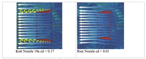

However, Rice developed different profiles that increased the efficiency of the airfoils which produces a nozzle with a 17:1 drag coefficient reduction.  Rice also developed a “thrust” nozzle that maximizes thrust characteristics over lower speeds forward and astern.
Figure 3: Kort and Rice Speed nozzle flow/drag images
The differences in operating characteristics between the Rice and Kort nozzles can be seen in the following tables showing Kort to Rice Speed nozzle, and Kort to Rice Thrust nozzle performance:
Regardless of which type of ducted propeller, it is clear that ducted propellers produce high efficiency when the speed of the vessel is between 10 and 15 knots, and competition between makers of ducted propellers is indicative of the role they play in producing power plants that produce greater BP for the same input horsepower.  However, the drag induced by the nozzles and fastening mechanisms increases along with the speed of the vessel until the drag offsets the gains of the nozzle design.  The nozzles designed for higher speeds have reduced backing efficiencies and increased astern maneuvering issues.  This makes ducted propellers ideal for slower vessels that require high thrust, such as tug boats, but not suitable for high speed resupply and support vessels.
