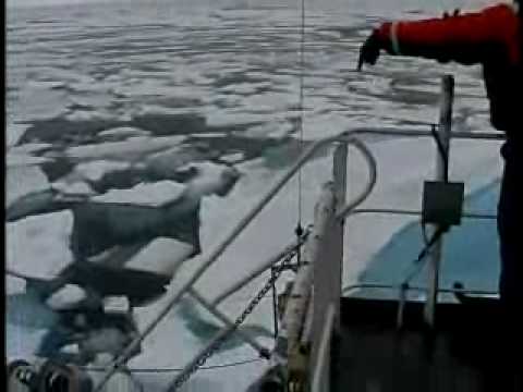

Great Video from Healy from 2007 Summer Cruise
YouTube Preview Image
