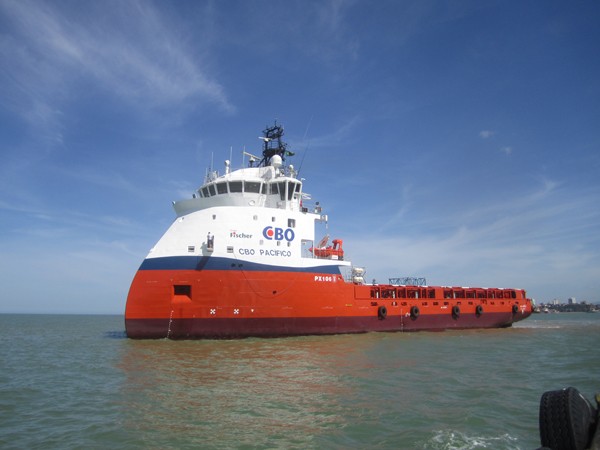

The platform supply vessel ‘CBO Pacifico’, designed by ULSTEIN, is delivered from Estaleiro Alianca in Brazil.
The ULSTEIN designed platform supply vessel ‘CBO Pacifico’ left the Estaleiro Alianca yard on May, 10 2012 and went straight into contract for Petrobras. The vessel is the second of the PX106 design delivered to CBO this year.

‘CBO Pacifico’ measures 76.3 metres (length overall) by 16 metres (breadth), and the depth to main deck is 7.5 metres. The cargo deck area is 660 square metres. Three of the tanks are multitanks of the Cargomax system. She has diesel electric propulsion and azimuth propellers, and can keep a speed of approximately 15 knots. ‘CBO Pacifico’ complies with the CLEAN notation from Det Norske Veritas.
