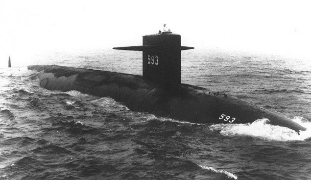

It’s been almost 50 years since USS Thresher (SSN-593) sank off the coast of Cape Cod, Massachusetts, claiming the lives of 129 Sailors and civilian technicians aboard.
Family members and dignitaries will remember the loss that led to a renowned submarine safety program during a ceremony this Saturday at 1 p.m. EDT in Portmouth, Maine.
Thresher, which was built at Portsmouth Naval Shipyard, Kittery, Maine, was the lead ship of a class of 3700-ton nuclear-powered attack submarines.
On April 10, 1963, Thresher began post-overhaul trials following lengthy testing and throughout evaluation of her many new technological features and weapons after her commissioning in August 1961.
Thresher transited with the submarine rescue ship Skylark (ASR-20) to an area approximately 220 miles east of Cape Cod and started deep-diving tests. Fifteen minutes after reaching her assigned test depth, Thresher informed Skylark of difficulties. Garbled transmissions indicated things were going wrong. Suddenly, listeners in Skylark heard a noise “like air rushing into an air tank” and then silence.
Efforts to reestablish contact with Thresher failed. A search group was formed to locate the submarine. Rescue ship Recovery (ASR-43) retrieved bits of debris, including gloves and bits of internal insulation. Photographs taken by bathyscaph Trieste proved the submarine had broken up, claiming all hands on board.
Thresher was officially declared lost April 12, 1963.
A Court of Inquiry was convened and determined the loss was in all probability due to a casting, piping or welding failure that flooded the engine room with water. This water probably caused electrical failures that automatically shut down the nuclear reactor, causing an initial power loss and the eventual loss of the boat.
