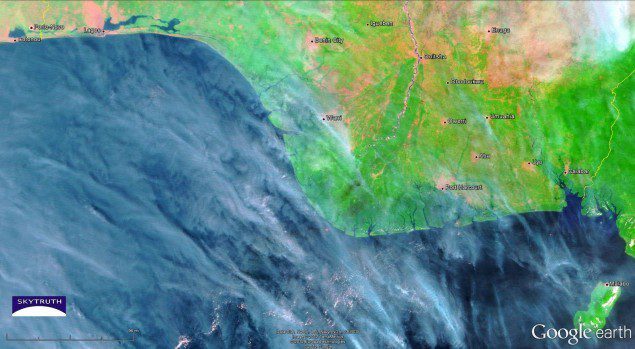

K.S. Endeavor jack up rig fire satellite photo
Detail of MODIS 7-2-1 infrared image along Niger Delta coastline, January 17, 2012. Bright red spot marks inferred location of the burning K.S. Endeavor jackup drill rig.
